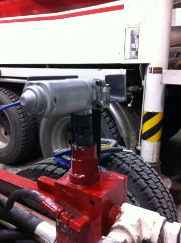

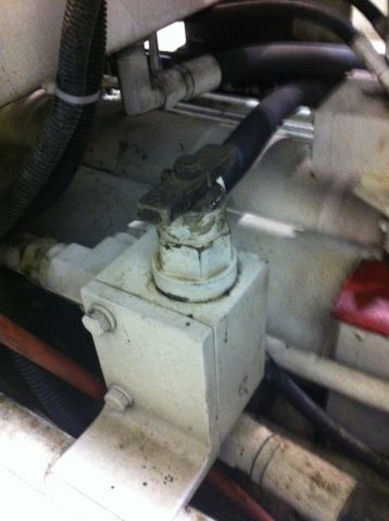

The remote is only half your problem. You will need something for the remote to signal. If you are wanting volume control not only do you need it on the remote you also need something to turn the valve once it gets the signal from the remote. The little motors that putz uses can get very expensive. I just went through this with my line pump. Luckily I had an extra button on my remote that had no purpose, so I gave it one. But I still had to have something to turn the valve. So I took a window motor and a coupler and with some creative wiring got it to work. The whole thing cost $45.00. Here is a before & after pic. |
| PumPro | 02-23-2013 | reply profile send pm notify |
After |
