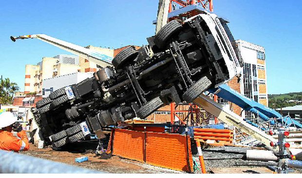

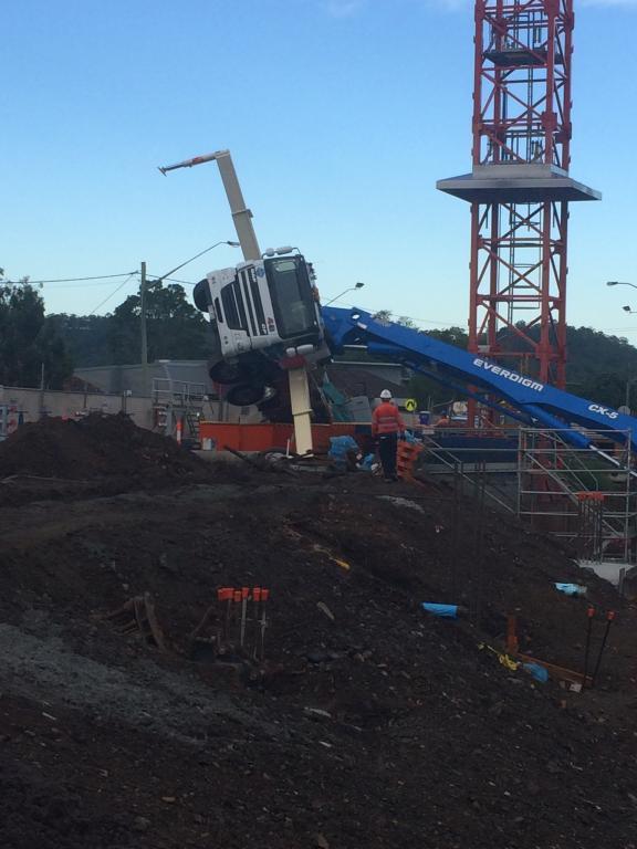

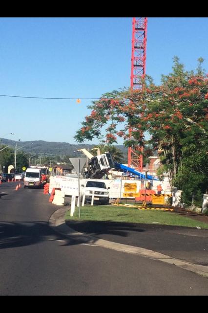

Construction workers at Lismore Base Hospital were lucky to escape uninjured when a concrete pumping truck toppled over at about 7.10 am this morning. Lismore police Inspector Susie Johnson said workers were operating the truck remotely, extending the boom and moving the stabilising legs on the vehicle, in preparation to pour a concrete slab when the incident happened. The construction site has been shut down and will be inspected by Com Care officials and engineers. The truck will remain on its side until inspections are completed. Construction on stage 3 of the hospital is expected to resume in the New Year.

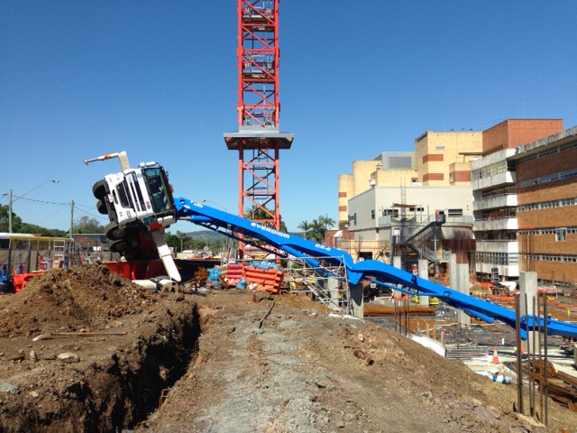

This is a good company and they operate a very professional operation and have over 24 pumps.
The operator was setting up and was about to adjust the end delivery hose.
The crane driver informed him that it would be better if they placed a steel plate
under the rear outrigger as the ground was not reliable.(this was great help from the site crew, as they wanted to make sure that there was a safe working base)
The operator, who has over 25 years experience, obliged and closed the left rear
outrigger so they could place the steel plate. While the plate was being installed the operator went back to continue to set up the end reducer and deliver hose with the safety chains.
Than he was informed that the steel plate was put in place. He forgot that the rear outrigger was closed and from the front of the truck, he started slewing the boom to a catastrophic end......the operator was shattered as he had never had an accident before. The fact that he changed his routine and started doing something out of the norm caused his lapse
of concentration....the moral is : SAFETY CHECKS AND PROCEDURES are important, but when routines are changed, the whole SET UP procedure has to be gone through again. A walk around the truck would have prevented this from happening. A lesson for all of us. |
