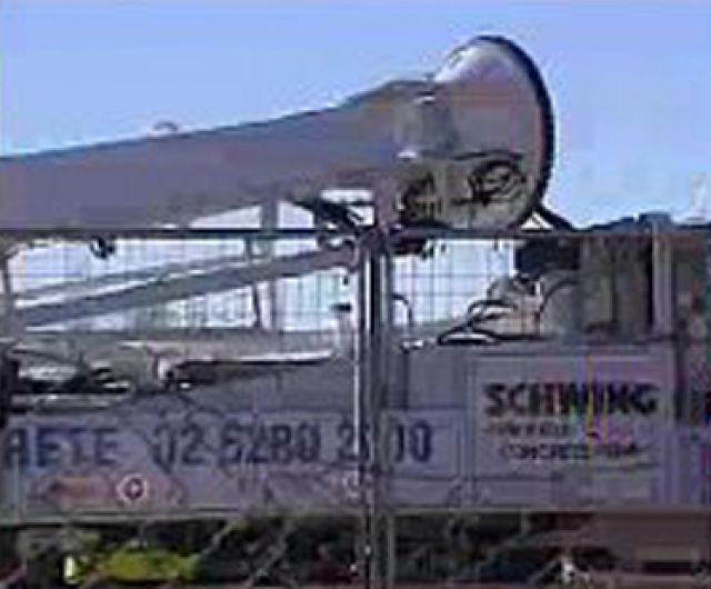

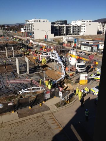

Our thoughts go out to those involved. http://au.news.yahoo.com/video/nsw/watch/30049724/concrete-pourer-kills-work http://www.canberratimes.com.au/act-news/aftermath-of-a-worksite-tragedy-20120721-22gf6.html |

Bad news for Schwing. When your title said placing boom I assumed it was on a building but it wasn't. Prayers for the family. |

39 meter, I heard there was a recall on some of the turret bolts on certain booms, I could be wrong but I heard that today. |

I heard it from a Schwing owner, he told me Schwing replaced the bolts, that there was a recall and his pump was not on the list for the recall but they replaced the bolts anyway. I would say your right double standard if I never posted anything about other mfg, but I do, look at the others in Canada and in the USA those where not Schwings. I guess bringing up a recall is bad in your eyes? Yes I would like to have Schwing as a sponsor but I am not going to treat them better than my sponsors, why would I do that. Why don't you call Schwing and ask them if there was a recall for those bolts before you lash out at me. I am not saying the bolts broke, I don't know what happen but I would keep an eye on my bolts if I owned a 39. |

Todd, Please note that that information you recieved is incorrect. Schwing does not have a recall in place for bolts or any other part of a 39. |

? Was this a brand new pump and it was out for the third pour.Looking at the video it looks like it just came out of the box. |
